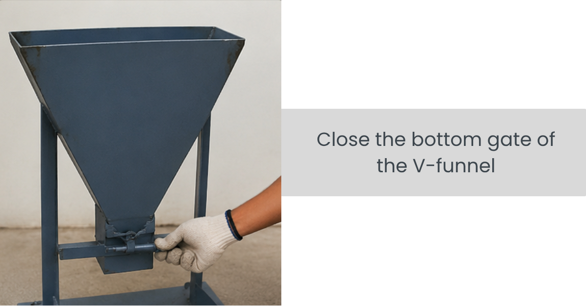

Before starting the test on V-funnel, the discharge gate located on the lower end of the V-shaped funnel needs to be closed. It will prevent the loss of the concrete during the filling process of the funnel. A properly closed gate will allow one to get accurate results from the test.

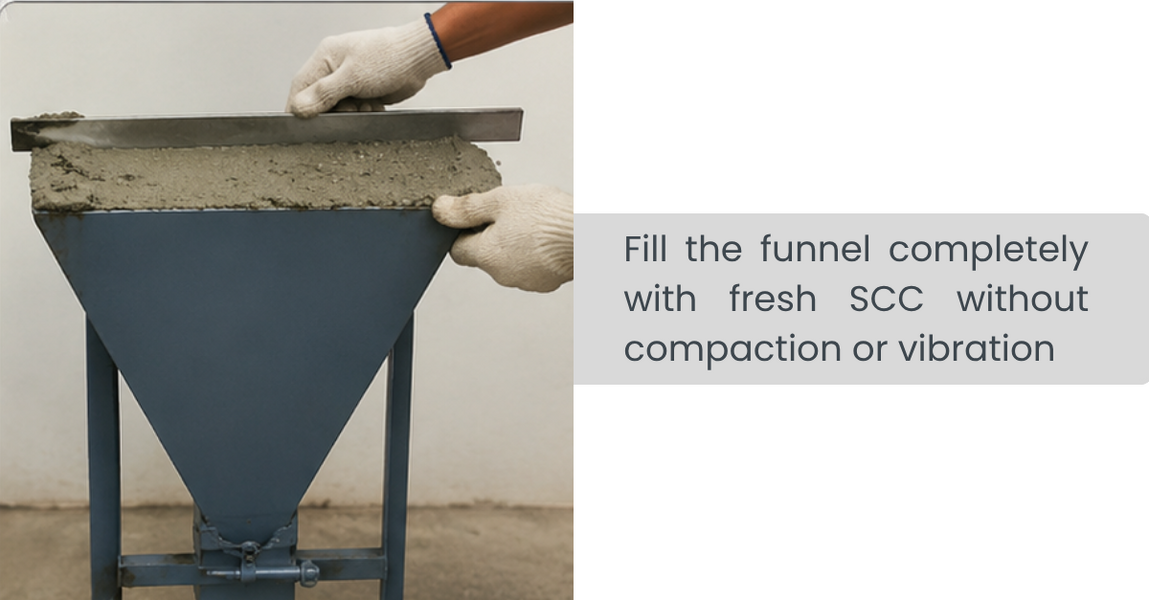

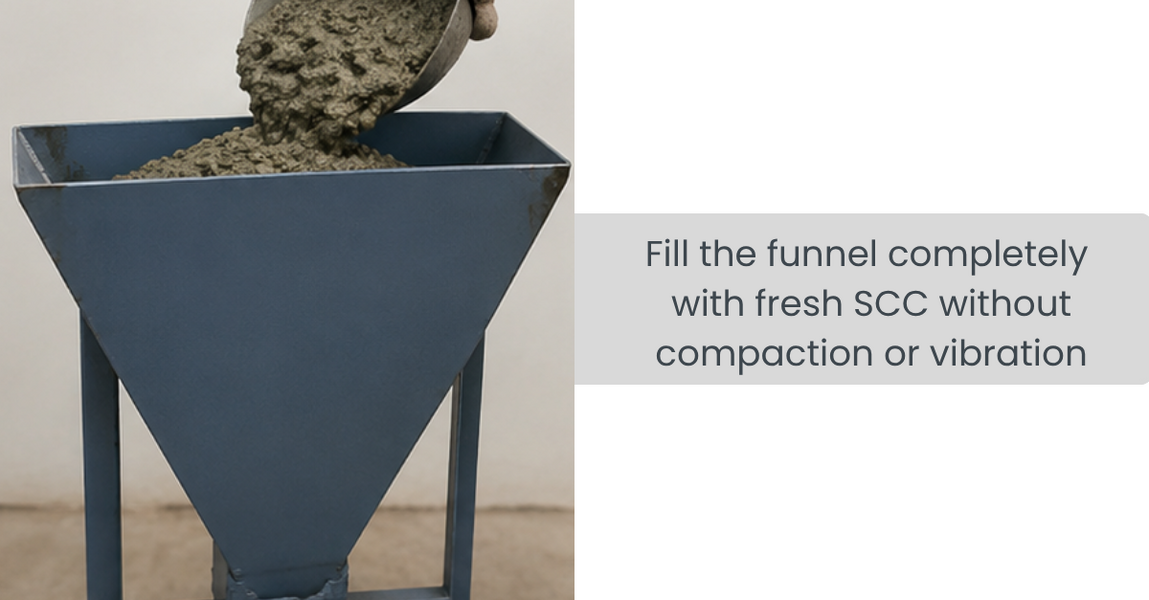

A fresh mixture of Self-compacting concrete (SCC) is placed in the V-funnel to fill it up. While filling the funnel, one cannot use any techniques such as compaction or vibration. In addition, tamping or rodding the SCC mix in the funnel should not be done because of self-leveling capabilities of the SCC mix.

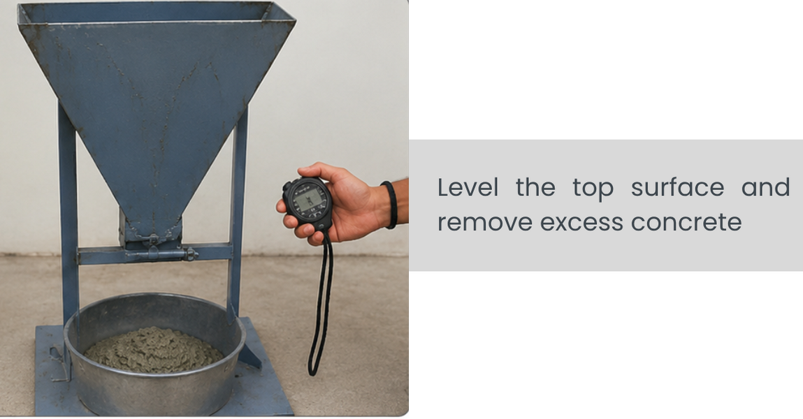

Once the funnel gets completely filled, excess concrete is removed by smoothing the top surface of the funnel. To accomplish the task of leveling, a trowel or straight edge can be used to smoothen the top surface.

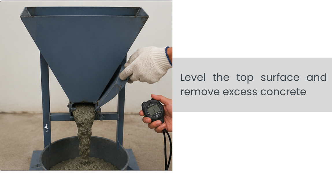

The bottom gate of the V-funnel is opened, and the stopwatch is turned on. At the moment the gate is opened, concrete starts flowing out through the funnel by the force of gravity. Precision in timing is very crucial as it will directly influence the results of the test.
The total time required for the complete discharge of concrete out of the funnel is recorded as V-funnel flow time (Tv).

Step 1: Closing of the Bottom Gate of the V-Funnel
Step 2: Filling the Funnel with Fresh SCC Without Compaction or Vibration
Step 3: Smoothing the Top Surface
Step 5: Measure the Total Time for the Complete Flow of Concrete
