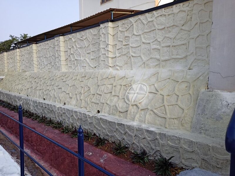

Dear Sir
Please guide/suggest for methodology for putting granite stone as in skirting in an undulation Random Rubble Masonry wall.Presently only pointing is there.I am going to attached the site for better idea.
Regards
Rajatmes
Prime CE
Dear Sir
Regards
Sir, you can do fix granite skirting on stone surface directly by using C2 class tile adhesive.
Do remove the pointing mortar from skirting area and make surface dressing (removal of paint from stone) by hand grinder.
Rajatmes
Prime CE
Good Evening Sir
Thanks for your replies.
I ve taken dubbing coat with chicken wire mesh for undulation and also as not to distrub existing pointing.After that chemical screed bed above plaster..
Is this will be better.
Regards.
