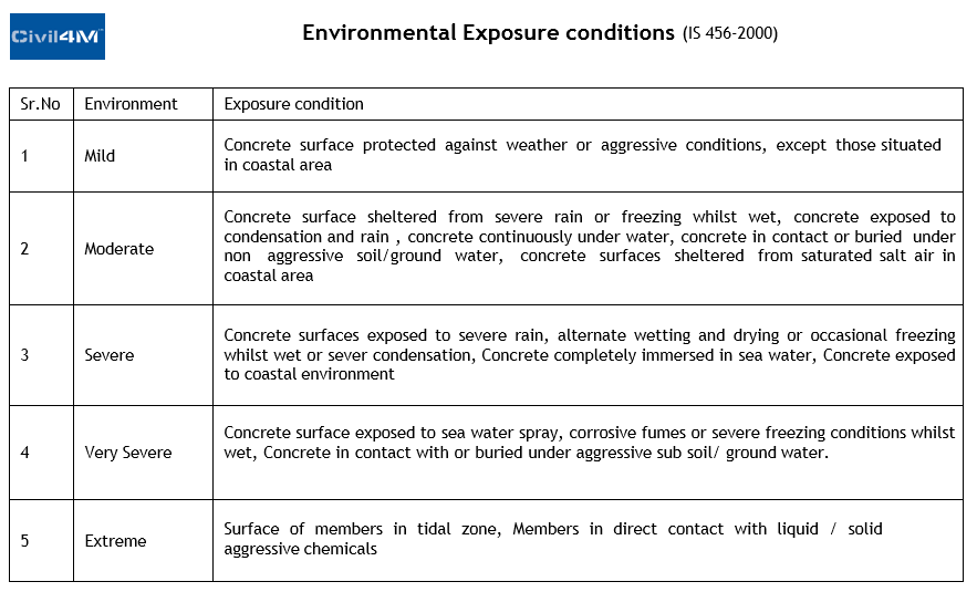

The various exposure condition are tabulated below

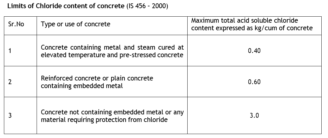

Chlorides in concrete:
If chloride is present in concrete, there is increased risk of corrosion of embedded steel. The higher the chlorides content or if the structure is exposed to warm moist conditions, the greater is the risk of corrosion. All the constituents may contain chloride and concrete may have contaminated by chloride from environment. To minimize the change of deterioration of concrete from harmful chemical salts, the levels of such harmful salts in concrete coming from concrete making material like cement. aggregate, water and admixture, as well as by diffusion from the environment should be limited. The total acid soluble chloride content should be calculated from the mix proportion and the measured chloride content of each of the constituents. The total chloride content (as Cl ) in concrete at the time of placing shall be as given below;

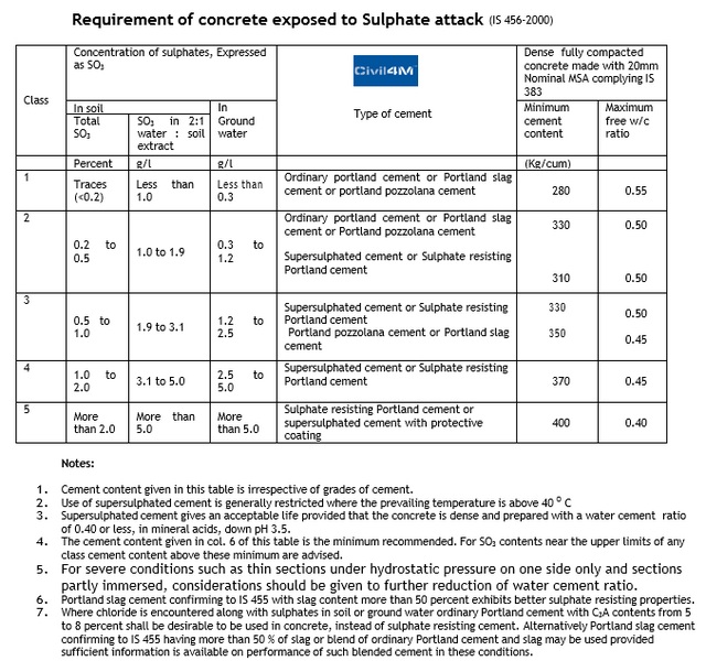

Sulphates in concrete
Sulphates are present in most cement and in some aggregates, excessive amounts of water-soluble sulphate from these or other mix constituents can cause expansion and disruption of concrete. To prevent this the total water soluble sulphate content of the concrete mix expressed as SO3 , should not exceed 4 % by ,mass of cement in the mix. The sulphate content to be calculated as the total from the various constituents of the mix.

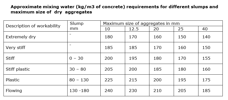

Step 3 : Select the water cement ratio for the type of exposure and for sulphate attack from table .
Step 4 : Calculate cement content as per water cement ration water quantity
cement quantity = estimated mixing water quantity from step 1 / water cement ration from step 3

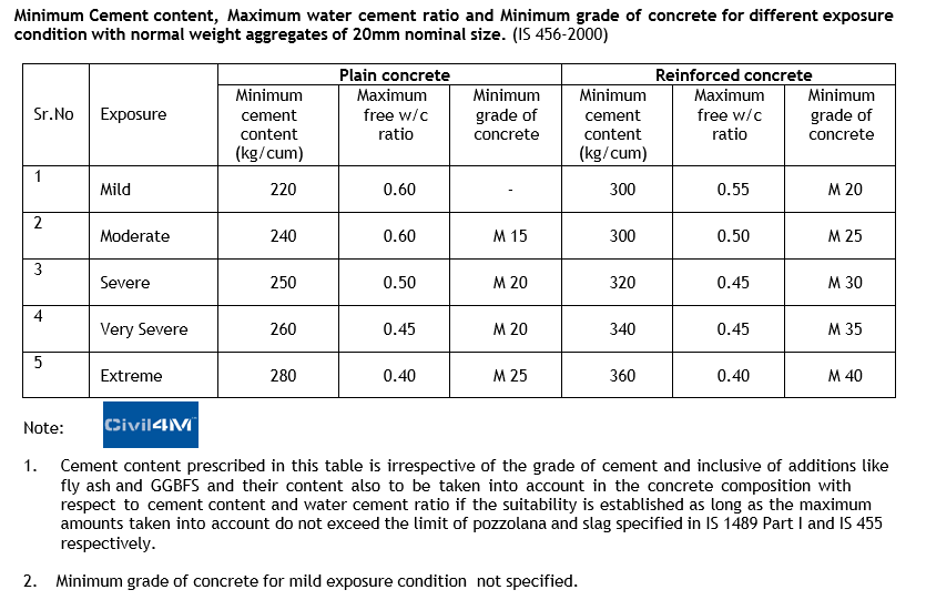

Step 5 : Check the cement content calculated for durability of concrete (click here to go to tables)
