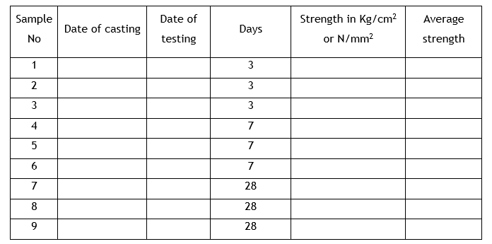

Observation Table:

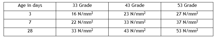

Limit: Minimum compressive strength in N/mm2 for different type of cement at different ages:
